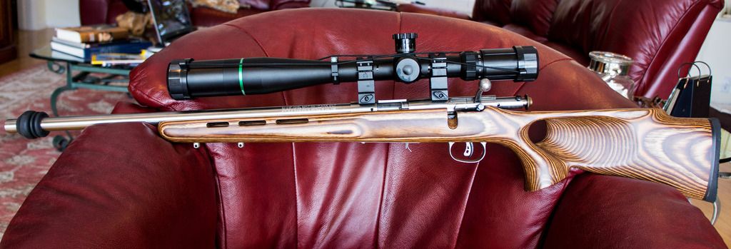

my wife's Savage 93R17 BTVSS left hand is scary accurate. at 100 yds, in low wind conditions, it shoots from the mid .3's to about an inch using CCI TNT ammo, which is the most consistently accurate we tried.
she shot ten five shot groups yesterday from the bench with a Sinclair F/TR bipod. aggregate average for all 10 groups was .62"!! the best group was .35"!!
we put in the Apache Accutrigger mod, which cut the trigger pull weight almost in half. we also installed the thicker bottom metal allowing for a bit more torque on the action screws. (not much more or you will crack the stock). scope is a Mueller 32x
she is thrilled with the way this little rifle shoots and also likes the pretty wood stock:)
