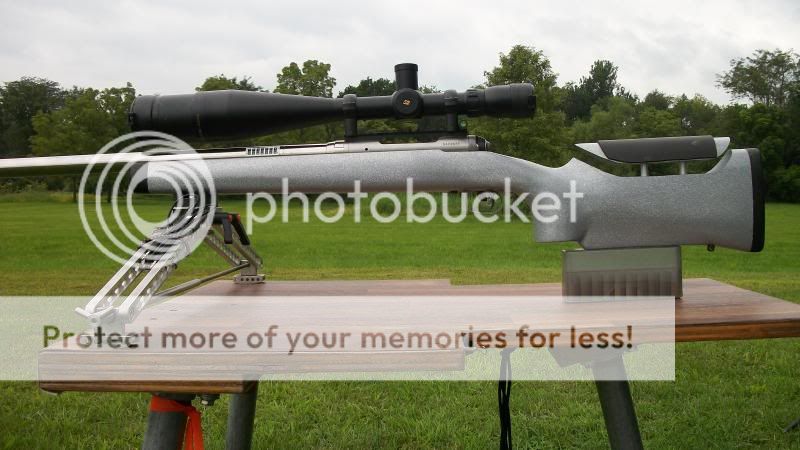

chevytruck_83 said:
does it really look that bad? your hurting my feelings.
No comment.....but you could send it to Speedy G.........he can make ANY bench gun look pretty.......although it might come back with a different action ???...and stock perhaps.......scopes lookin' good though ::)
I live in a motorhome (its in the background of the first pic). When my wife and I first moved into the MH, I carried and loaded for 6 rifles. But that got to be a bit much so now I am down to two rifles and four barrels - both Savages. I'm not going to make any MOA accuracy claims because it really is irrelevant. The pictured Savage started life as a 22-250 and it was easily the most accurate stock factory rifle I have ever owned. In fact, up until I bought that Savage 12BVSS in 22-250, all my rifles were either Remington or Winchester.
The Savage as pictured is sporting a Criterion 243AI barrel. Other than the barrel, all rifle parts are Savage - action, bolt, trigger, and stock. The rifle is as accurate as I need or want it to be, killing groundhogs over 1000 yards distance. I happen to like the looks of it. And I really don't care if anyone else thinks it is butt ugly or not.
And that attitude is why you, me and The Viper get along so well!!!! See, we can like different things and still be friends and fellow shooters folks! 8)
