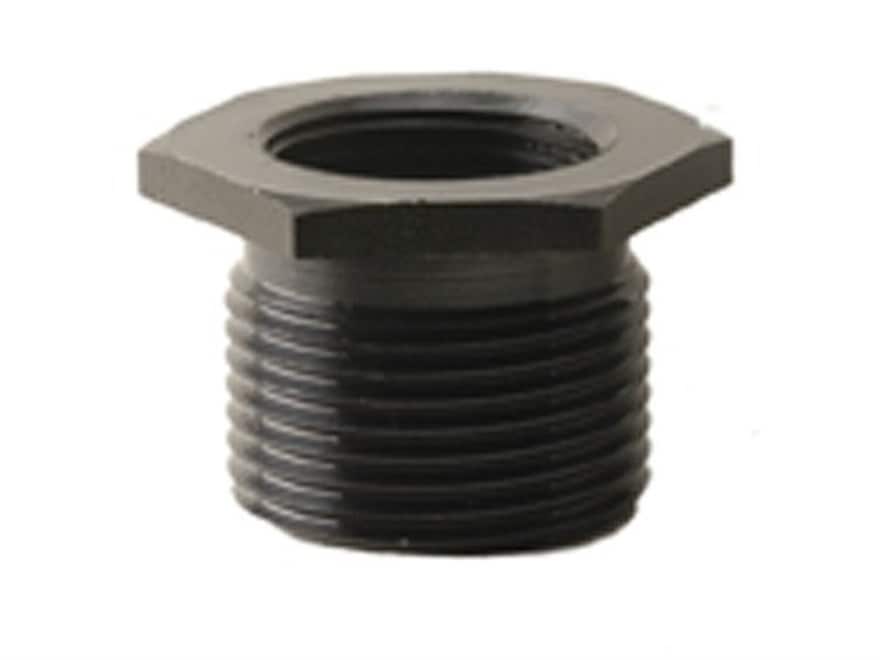

Is there a insert available to to convert it to standard screw in die with lock ring?
I’m thinking a threaded bushing from a RCBS rock chucker press.

That all said RCBS make a conversion to the Hordandy bushing system for there Rock chucker presses . You have to take the factory threaded section out and screw in the bushing adaptor . The question would be will the factory RCBS piece they take out thread into the Hornady press if you remove the bushing insert piece . I don't know if the two presses use the same threading to match .
They apparently make this in both 1.5 inch and 1.25 inch sizes so you need to know the size of the original Hornady hole. I am guessing it is 1.25 inches. But YMMV
Here is the 1.25 conversion . but you have to be sure the Hornady is 1-1/4 x12 first

The Hornady press holes are threaded 1-1/4" x 12tpi, same as most presses with a bushing. The LNL receiver screws into that, so any insert that converts from that to 7/8" x 14 should work.
Lee has them at $20 retail per piece. Midway had the RCBS adaptors at near $60/ea, but now lists them as discontinued (don't know if that's Midway or RCBS that discontinued them.)
