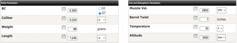

Run the numbers yourself here:
https://bergerbullets.com/twist-rate-calculator/
It will give you a better feel for the minimum twist rate necessary at your specific elevation and atmospheric conditions. OAL for the 88s is ~1.240" and the average G7 BC in my hands is ~0.300.
Nope, not according to Berger stability twist rate chart. Not even at 4000 feet and 80 degrees. Elevation being the largest variable. You only get to 1.3 and ya need at least 1.5 on the chart. They say it may be able to shoot good groups at short range but it's not stable, and a significant loss of BC will occur. The box of 88 eldm I have say 7 twist. I shoot them in a 6.5 twist.
Maybe you should look into the concept of gyroscopic stability a little deeper than you apparently have. I've shot many of the 88s out of a 6.8-twist barrel. Other than the jacket failures, they were fine. They shot well and they were not even remotely close to being gyroscopically unstable.
So exactly where is it written that an Sg of 1.5 is the minimum? That actually came from Bryan Litz. However, for some time prior to using 1.5 as the current "minimum" acceptable Sg for "full stability and BC", the minimum necessary Sg he touted was 1.4. So which is it? 1.4? 1.5? Maybe next month it will be 1.6. The fact of the matter is that bullets running at an Sg of 1.4, or even as low as 1.25 to 1.30 don't just fall out of the sky. Nor are they gyroscopically "unstable". They merely behave as if the BC is a bit lower than it actually is. Maybe you're unaware of this fact, but the gyroscopic stability of a bullet actually increases as it goes downrange because the linear velocity falls off much faster than the rotational velocity. Thus, the bullet gyroscopic stability actually increases throughout its super-sonic trajectory. Unless someone were running the 88s out of a short barrel at a velocity of only 2570 fps (or less), they would still retain an Sg of 1.40, which is more than sufficient for reasonable performance, exactly as I stated. Even Hornady suggests that a 1:7 twist is sufficient. In fact, their minimum recommended twist rate for the 88s is...wait for it...1:7. Do you really think they would recommend a twist rate that was grossly insufficient as you seem to be implying?
BTW - below is the actual output from Berger's Twist Rate Calculator for the 88 ELDM using G7 BC = 0.300, OAL = 1.245", 2850 fps, 7-twist, 70 degrees F, and 1000 ft elevation as the inputs. It seems a bit different that what you claimed. In fairness, Berger's Twist Rate Calculator does not have an input for ballistics tips, which the 88 has. But that's really a moot point because if you use a twist rate stability calculators such as JBM, which does have a ballistic tip input, the predicted Sg only gets higher.

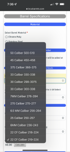

I use Bartlein .219, but this is straight from Bruxs website. Unless their order form is incorrect it appears they do.
What barrel maker offering 0.219" bore barrels. I know Brux doesn't. Thanks
As Jeremy already noted, Bartlien does. I believe they refer to the 0.219 bore barrels as their "5.56 cal barrels". I have only used Bartlein, so you'd need to call anyone else directly and ask.
Hawk Hill lists .218 and .219
Muller Works, Shilen, Rock Creek don’t list bore sizes online. Pretty sure Krieger is only .218 also.
