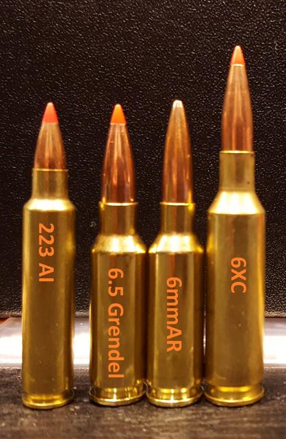

I think the 6mm ARC is a great idea! I'm already invested in a 6mmAR so it's nothing new for me......Even though it's slightly different the ARC ballistics will probably match or be very close. I love my 6mm AR and won't be switching any time soon since the process to make brass is so simple........it wouldn't be worth the cost for me to go with the latest and greatest when I have an original.
