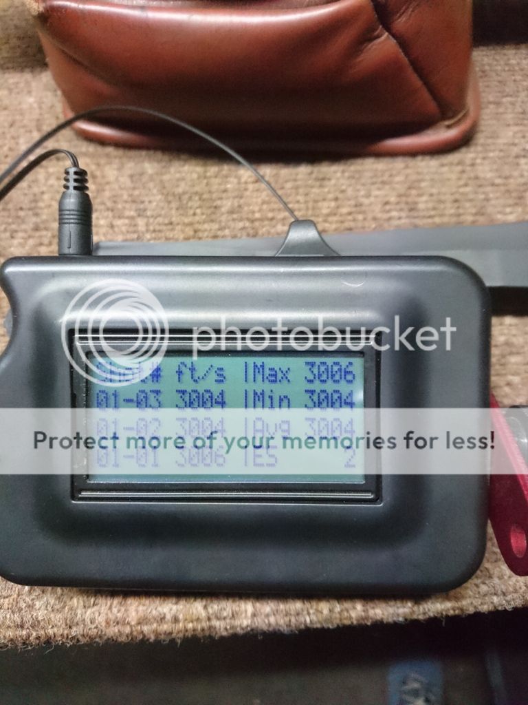

Montana im a bit pressed for time so didnt read al the replys but in my SLR i found it wanted a bit more neck tension than id usually run. Im shooting the equivalent to H4831in my SLR with Lapua brass and Molyd 95gr Berger. I checked the internal h2o volumes of around 15 pieces of brass after the 1st fire and they were so close I just loaded and shot them from there. Necks are also turned to 10thou, I uped the load a bit and its running rite at 3180fps now with the same low ES
