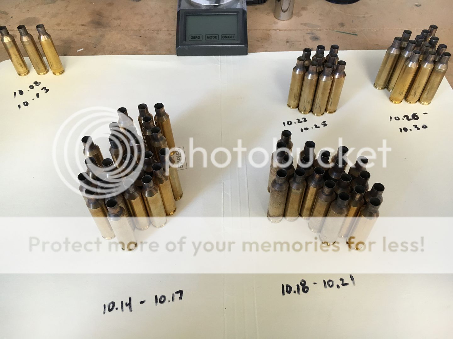

I would agree with that if I was using Lapua but Winchester well.... Let's just say I've seen some pretty extreme spread in case weight.
This is what I came up with for case weights. This is the first time I've done it so any and all advice and feedback is welcome. Thanks.
Weights are in grams.
So as far as I can tell, weight range is 10.08 grams (155.6 grains) to 10.30 grams (160.0 grains) about a 4.4 grains spread so not terrible.
