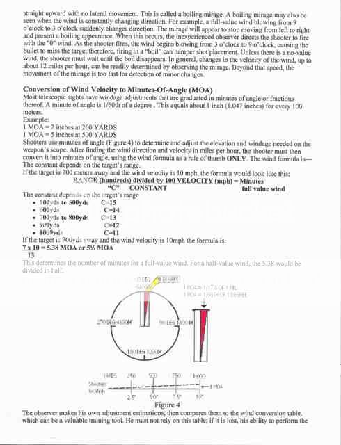

Spin Drift --- no problem look at the attached Charts. Anyone needs the original files shoot me a PM and I will send them to you email.
ENJOY!!!! Catman will like this!!!

CatShooter said:
Your charts do not relate to "spin drift".
I would have to concur sir. I saw nothing that mentioned the coriolis effect, aka spin drift. Good to see ya back, like the string idea also.
Ok whatever you say-------look at the 6'oclock wind direction and then look at corresponding impact point. Now look at the 12 o'clock and look at the impact point. This incorporates good old "Gaspards" best work----now you were saying my learned friend??:nono:

Deals mainly with heavy artillery that shoots miles away not hundreds of yards away but, can/should be used in the shooting sports. Deals with the rotation of the earth and the effects it has on POI as related to POA, a 6 or 12 o’clock wind has no bearing on the topic. That would fall under external ballistics of the projectile.
Spin drift would be approx. 1/4 moa at 400 yards, 1-1.5 moa at 1k.
Yes I am familiar with Gaspard Gustave Coriolis as you will note above the 6 and 12'oclock makes it easier to see the effect. Look closely and you will see it in the others as well. It takes both the Magnus and Coriolis effects into account---but depending on if you were shooting north or south for the later. Of the 2 the Magnus is the most significant for the shooter as most ranges are short compared to artillery.

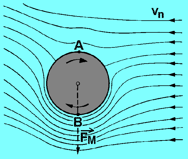

Magnus Effect,from Wiki)
Spin stabilized projectiles are affected by the Magnus effect, whereby the spin of the bullet creates a force acting either up or down, perpendicular to the sideways vector of the wind. In the simple case of horizontal wind, and a right hand,clockwise) direction of rotation, the Magnus effect induced pressure differences around the bullet cause a downward force to act on the projectile, affecting its point of impact.[8]
The Magnus effect has a significant role in bullet stability because the Magnus force does not act upon the bullet's center of gravity, but the center of pressure affecting the yaw of the bullet. The Magnus effect will act as a destabilizing force on any bullet with a center of pressure located ahead of the center of gravity, while conversely acting as a stabilizing force on any bullet with the center of pressure located behind the center of gravity. The location of the center of pressure depends on the flow field structure, in other words, depending on whether the bullet is in supersonic, transonic or subsonic flight. What this means in practice depends on the shape and other attributes of the bullet, in any case the Magnus force greatly affects stability because it tries to "twist" the bullet along its flight path.[9][10]
Magnus Effect
