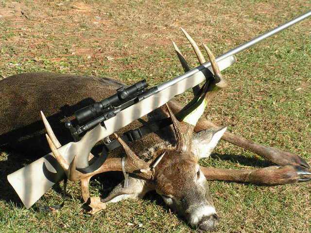

I built a 25-204 sixteen years ago and it has done yeoman duty, matching original factory ballistics for the 250-3000 and 257 Roberts 100gr Partition at 2850fps, I had a small boltface action available.
25-204 success
If I were to do it again I'd go with a 7.62x39 Mini-Mauser action and build a 25x39/25-6.5G and drop it in a nice Mannlicher style stock. Though the 6.5 Grendel is pretty decent also, I have one of those in a bolt-action also.
only .007 larger and is pretty handy also Mini Howa in 6.5G
