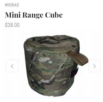

Front rest on both RPR's is just a regular old harris 6-9 with a swivel lock on it. I put the feet on a small bag and "settle" them in rather than shooting it off a concrete bench. No change there either.

Bipod is a standard harris 6-9, notched, rubber feet. Rear bag is pretty standard weibad mini range cube. Neither of these have changed in 2+ years on my setup.

Honestly for shooting with a narrow Harris front bipod and Wiebad range cube in the back you are doing well. Face it Harris bipods hop and shake on recoil, and that rear cube is a joke compared to a proper large footprint rear bag with ears.
