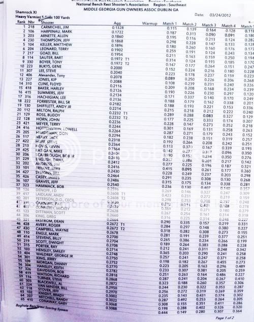

you usually have to shoot in the .1's at 100 to shoot in .2"s at 200. Are you talking MOA? Your gun/load needs to be the very best and you can not make any mistake on shooting it or reading the conditions. I shoot in the desert and the mirage is real bad, most of the time the target will be moving more than .250" at 200.
Let me illustrate my other post. The aggregate group size at 100 yards, read it and see what I'm talking about, Some of these shooters are world class shooters with custon rifles costing in excess of $3500.00!

Only trying to illustrate that a .25 group at 200 yards is not an all day, every day occurrence, even among those with the absolute best equipment, wind flags and a lot of experience. An all day every day .50 group shooting rifle in very experienced hands is hard to come by at best.
Mark
You got it right when you said "Maybe my expectations are too Interent oriented."
People that can shoot .250 groups at 200 yards on the Internet are a dime a dozen, and not only can they do it, they can do it "all day long". On the other hand people that can actually do it in real life are few and far between. Mark's posting of the scores are indicitive of what is really going on. Note those scores are with a heavy varmint rifle. While light varmint scores will be close, they are still going to be on average slightly bigger.
I have a couple of those expensive rifles and I'm happy to shoot .250 groups at 100 yards and half inch groups at 200 yards. I'm very happy when I get a few groups in the teens at 100 and 1/4 inch at 200. It isn't as easy to shoot tiny groups as the Internet shooters think.
