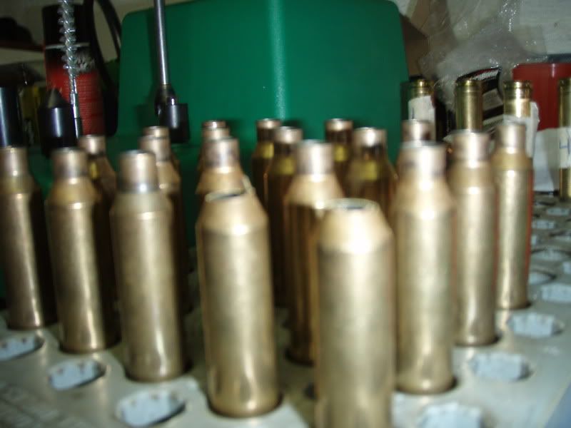

good thread guys . I've just been reading trying to learn something about this . I'll share my story now . 6 or 8 years ago I bought a new bag of rem brass for my 7mm rem mag . on the second fire the case neck would be broken off left in the chamber . all I had to do was tip the barrel up and the neck would fall out . I decided to junk the brass so a year or so goes by and I decided to pull the bullets and save what I could . this was the first time I ever seen this corrosion or welding . I was using a standard rcbs die with the expander ball . at that time I was using hornady one shot lube , I've stopped using it now . these were loaded with rl22 powder and hornady sst bullets . I have no idea what my neck tension was , sorry . I don't wear gloves while I load , and I do sweat easily , I have often thought about this being my problem . here are a few pics I have .
don't get excited about the cases being bent up at the bottom , there not . it's a reflection from the hex holes in the loading tray . these are ones that broke off on the second shot . these were only loaded for a few days before I fired them .
this photo shows the corrosion or weld were talking about .
