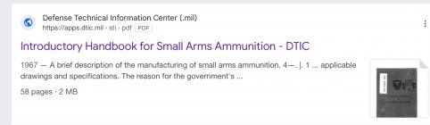

I did some searching and found this info. Seems the Military uses a “waterproofing “ compound in the neck of the case. Maybe it’s their answer to bullet weld? Here’s the info I found:
