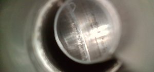

Yep! I use Free All, which has MIBK, and seems to keep the carbon ring down to a stain. It also has oleic acid, which I get out with Patch Out. Pic is at 982 rounds.
