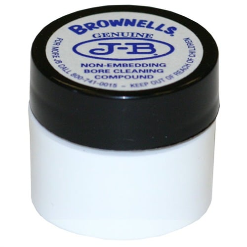

J.B. on a patch wrapped around a bronze brush will get it out in short order. I put a couple drops of solvent on the patch. Make sure you use a bore guide and put the guide on the rod before you put the brush and JB'd patch on the rod. After you're done, clean the rod guide and then push some wet patches through the bore before giving it a good brushing.
Hope this helps. -Al

Which version of JB should I buy?
I've used this JB for years:

Working the JB into a patch and then wrapping it around the brush gives more contact area with the bore.
I usually place the bore guide in the action and then insert the wand with the products.
With the guide in the action, a lot of the JB on the patch ends up inside the bore guide.
Good shootin' :) -Al
