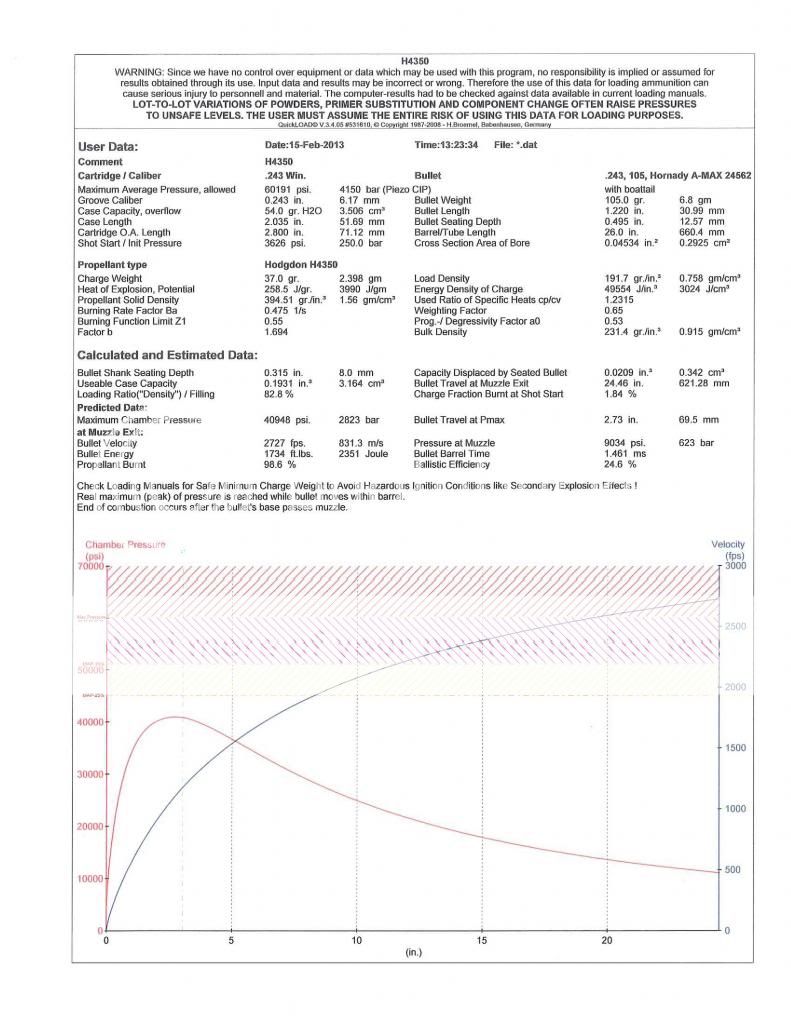

Here is the Quickload data Ive been looking at.
37gn seems fairly conservative.

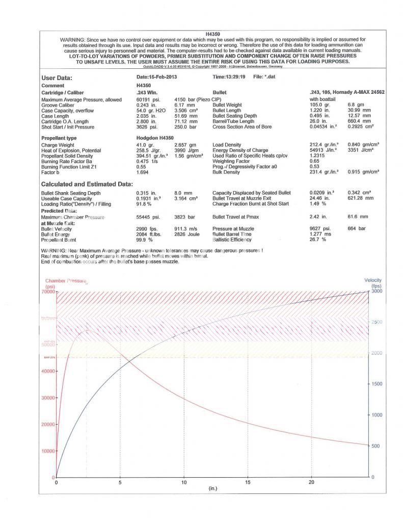

Second page is the Quickload data at 41gn that I plan on working up to, still seems pretty safe in regards to pressure...?
