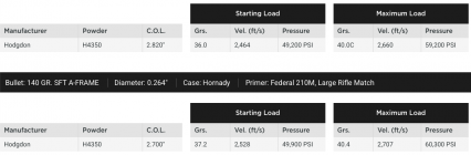

This is exactly why it is recommended to start low and work up to a safe charge weight. I can speak from experience that a charge weight of 43.5G of H4350 in a 6.5 Creedmoor is a HOT load. Most of my rifles have been no more than 42.0 grains in a 24" barrel. Below is the load data from Hodgdon for 6.5 Creedmoor using a 140 grain bullet with H4350:
