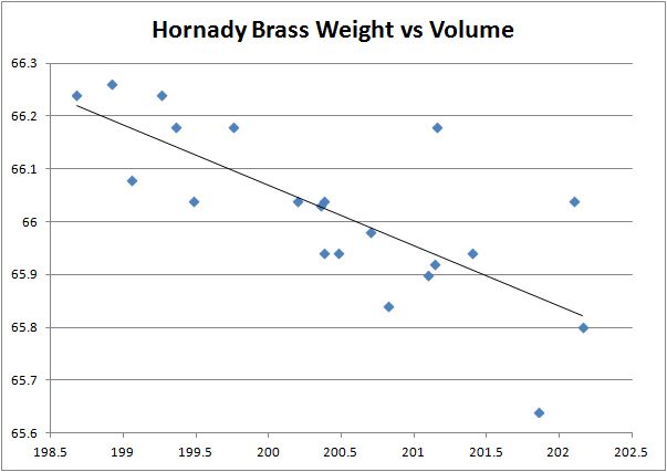

Attached below is the raw data. Whatever comparisons need to be drawn can be derived from this data. I sorted velocity from low to high and data was sorted this way not by case volume. I hope this helps.
Thanks! That's perfect. Having the individual velocities matched to each case capacity is actually way more helpful than just an average of two lots. I've parsed some of the data for you.
First, let's just run a scatter plot showing the capacity vs velocity with a trend line.
You can see in the scatter plot that there are two or three clear velocity outliers that fall well outside the trend. Two are low velocity rounds that were "mid pack" for capacity. There's also one, less severe, high velocity outlier that was on a lower capacity case. However, even with those outliers the trend line appears quite clear.
If you parse it by average velocity, dividing into a "low volume" lot and a "high volume" lot you can also calculate an average difference. I would lean towards tossing those two low velocity rounds out of the data set (There's one in each lot). With the remaining 19 cases divided into two lots, you get the following...

Thank you for running the numbers Sheldon. The results were close to QL estimates...only inverse.
I've been wracking my brain trying to figure out why the data doesn't seem to make sense.
Thinking back on it I noticed some case mouths were not uniform so as a handloader I fixed the issue by running all the brass through the resizing die.
Running a test I should not have done this. I know now I changed the internal volume by doing this.
I'm still not sure if that explains the inverse function...
I have another set of brass and corresponding weight data. I'm going to try this one more time. This is the Hornady brass brand new and unsized. Ideally I should have sized before weighing. I guess I could size than re-weigh?
I'm willing to rerun the test. I would need input on the parameters as I obviously screwed up the last test...this is a little bit beyond the scope of my experience.
If there's still no correlation than at least we know it wasn't from human error.

Very cool info. Thanks again for sharing. Would love to see more results once you have time to resume your testing. Would love to try and extrapolate your data to see if there is merit in sorting brass cases by weight (a fairly common practice, compared to volume weighing) and if there would be any merit to sorting cases by velocity and comparing the subsequent firings.
The Hornady brass came with a rifle I purchased on these forums as a package deal. It came with a lot of extras.
I've done primer tests in the past but until the numbers get lower it's very difficult to determine which variable is causing the variation in velocity.
The primers are CCI BR-2.
Powder drop is down to +/- 0.02 grains. That's about one kernel of powder. I won't be able to weigh more precisely unless I get a $1,000 scale or a Prometheus.
I am disappointed that the more precise powder drop didn't seem to improve my ES. I think my numbers were actually worse. I was shooting a light load. I wonder if the change in case fill caused changes in pressure and ultimately fps.
