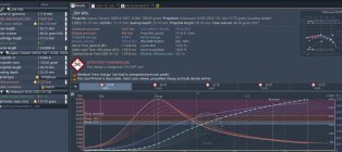

I am losing confidence in GRT. Wanted to model velocity using n165 in .284 win.
VV reloading database shows 57.7 as max load and shows 2651 fps for a 24" barrel shooting 180gr Scenars.
I put exactly the same data into GRT and it shows overpressure and 2955 fps out of 24" barrel. nonsense.

case length is correct, as well as barrel length. we are not talking about precise modeling here.
using standard values we get 2955 fps out of 24" barrel. it's just wrong.
try repeating that in your GRT.View attachment 1591505
It’s hard to tell on my phone, but it looks like your OALis 71mm, and you have 22mm of bullet in the neck. That seems wrong. Shouldn’t your OAL be in the 80+mm range?
Ok, already found one error.. VV load data shows a COAL of 74.0mm. You are using a COAL of 71.12mm.
That is going to make a big difference in pressure!

I used all the defaults from GRT but COAL to 2.91" to match VV's load data. 57.7 gr of 165 still shows Fill Ratio of 114.6% and a peak pressure of 84.4K psi.
Either VV's load data or GRT is incorrect.

I also found another problem is in the bullet. Lapua shows the bullet is a boat tail bullet, While both GRT and quickload shows the bullet as a flatbase bullet. Without having the actual bullet measurements though, no way to fix as Lapua does not provide that data. I found this once with a Nosler 44M bullet where the starting loads provided by Nosler would show as an overload in Quickload. after measuring some bullets, I found out that the bullet length was wrong that Nosler listed. After entering the bullet length I measured, the Data almost matched.
