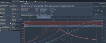

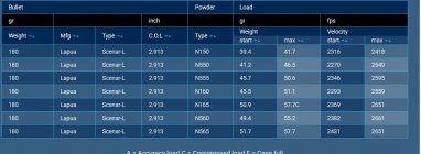

VV reloading data shows 57.7gr of N165 is perfectly safe for .284 win whereas GRT show huge overpressure. 180gr bullets in both cases.

Question(s)? Are you using dimensions for the Scenar L bullet in GRT? Would it make a difference in the final outcome?
Also, the OAL that is spec in both are different by a good bit -would this make a difference? (the OAL difference is a bit more than 0.100").
Not trying to be a richard, but trying to learn. (and trying to learn if simulations are worth the time and money).
Frank
I used the defaults in GRT for Sierra 180 SMK. Shows a peak pressure of 80K - a wannabe Fury.
Thanks Laurie. It seems to me that VV data show surprisingly low velocity at 57.7- 2651 fps. 57gr in GRT and 2851fps seems plausible.

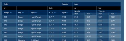

In most cases discrepancies between VV website and GRT are within reasonable margin of error. Like the one popular load below in 6.5 creed (13fps difference).6.5 creed grt.jpg
