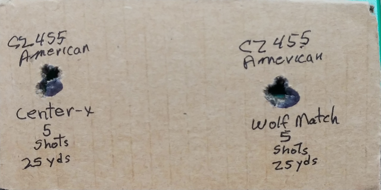

Breaking in the CZ 455 American with 6 different types of ammo, Vortex 3-15x44 Gen ll. The center-x measured .40 edge to edge and the wolf was .35in. Guess I will play with these 2 a little more. Bolt still a bit gritty.
Is there 25 yard competition shoots in your area ? Try that CZ at 50 yds.

BTW- It looks like a cinch that you will be .6 MOA at 50 yards.
