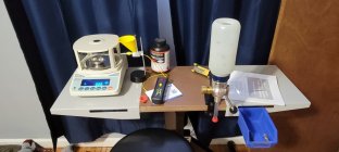

Ohaus Scout SPX123, very similar specs/performance as the FX201i, but at $417 (Amazon)-$429 (H&C Weighing), but it does not have the enclosure and isn't programmed for auto-tricklers. I've been using the Scout for 2 yrs with excellent results, hand trickling. Very stable, but I do have to turn off the HVAC to settle the air in the room (my garage shop). I've taken to using a 100 grain "Fake Zero" to move it away from its "auto-zero".
