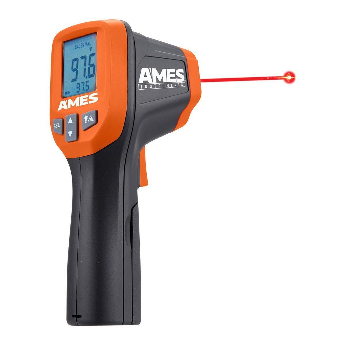

You'd be surprised how useful they are....a guide when removing glued in actions, checking 'annealing' temperature, etc. This one is under $25 and fits in your pocket.
If Christmas is too far away, Harbor Freight has this one that works well for about $15.
It’s nice to see the size come down - that would make a good stocking stuffer. I’ve really liked the narrow beam models from Kline - electricians use that model to check the temp of individual electrical connections, but it’s nice to use with any large or small parts.
