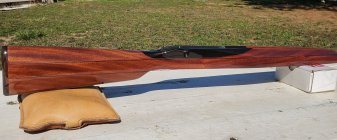

Xring broke out at bolt slot you can see glue line. Panda action20211223_101417.jpg
Fellas I'm not knocking glue ins I'm just a voice of reason, and caution.
If you want to glue it, glue away.
Now if by chance some unfortunate shit happens
I charge $600 + USPS priority shipping.
Xring broke out at bolt slot you can see glue line. Panda actionView attachment 1497049
Terry Leonard same thing bolt slot to tang broke.View attachment 1497051
Escutcheon removal, I stripped and repainted stockView attachment 1497050
Scorched paintView attachment 1497053
Just remember...View attachment 1497052

That copper colored stock looks familiar, Hard to say but is it one that I've worked on? You may or may not have any way of knowing by now.

Xring came by way of Dusty for Tommie, I cut toe and pistol grip for poodle shooting.
Terry Leonard came from Greg Brooks.
Red & green stocks came from Zack,
Red stock had just been cut and had rudder installed. It was getting repainted irregardless.
Green stock, what can I say shit happens.
