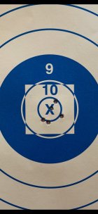

To channel @Dave Way, the Henderson works fine for me. The pic is 3.855" at 1000 yds. However, my group was only the second best that day was beaten by @GlennK by better than an inch, setting a new IBS record. Maybe Glenn uses a Giraud....... ;)
However, I don't think trimming is that important so either trimmer works fine. That said, a trimmer that indexes of the shoulder, like the Giraud, is theoretically more accurate as @BoydAllen has been saying.
That is because upon firing, the case expands to fill the chamber. I think that happens before the neck expands off the bullet. This means the critical dimension is the measurement from the shoulder to the case mouth. And as perfect as some of like to load for our competition rifles, there will always be some variation in shoulder bump.....even when we have convinced ourselves that we are consistently measuring to .0005" with our Mitituyo calipers.
