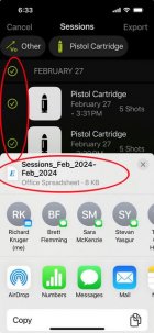

Update: Just off the phone with a Garmin Xero support dude. New to him. While on the phone we determined the difference is exporting individual shot groups, it goes as CVS format and values come across into Excel as numbers. But, selecting multiple shot groups (see image below) causes the ShotView app to export as XLSX format with multiple sheets (which cannot exist in a CSV file) and that is where the numbers are formatted as text. He is passing the issue on to the tech group, but for now the only way is to export individual shot groups. That is more work than the only other reasonable solution I found is to do a block copy of all the info in a shot group sheet to NotePad and then back into Excel. Exporting individual shot groups is way more work as each are sent via email and each file has to be saved from email to the PC and then individually opened in Excel, yada, yada, yada...

Use the Home tab, in the app, and export 1 session. It's a csv. Below is one of mine.
You're selecting multiple, from the "Sessions" tab?

1. I just exported multiple sessions to xlsx file from my iPhone
2. Open the file in excel
3. notice all the data fields are stored as text. There is a green triangle error for each of the data cells which states that the number is stored as text:
4. You can tell that the number is stored as text since the number is "left aligned" in the cell with a green triangle warning.
5. Highlight all the data
6. select the yellow triangle ! dropdown
7. select "Convert" to Number
8. Notice all the data is now stored as "number". Numbers are "right-aligned", and the green triangle warning is gone.
