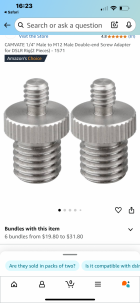

Mine is mounted on the left post of my NEO X and it never misses a shot. I the following pieces on Amazon:
Then just adjust the quick change base that screws to the bottom of the Garmin so it is facing forward when the quick change mount is tight on the NEO X post. It's worked great for over a year with no missed shots.
FCLASSPRODUCTS.com also sells a mount for $60 if you would rather go that route.
