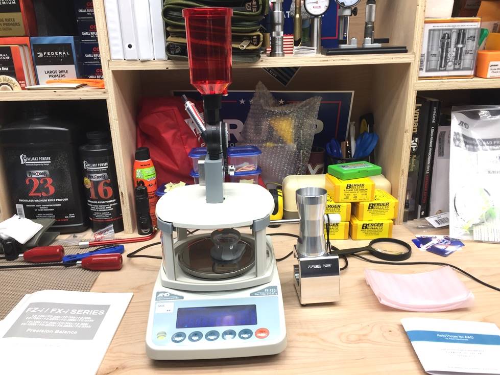

Got mine today, unpacked it and all I can say so far is wow! Going to set it up and compair it to my Dillon D-terminator that I’ve been using for the last ten years or so, been a great scale (I think), be interesting to see how my loads have compaired! Have my calendar marked for 6-weeks to be on the lookout for the rebate, said 6-8 weeks so we’ll see.

So I ordered the whole kit ( scale, trickler and thrower) 2 weeks ago to replace my Gempro and UPS is going to drop it off this Friday. Looking forward to speeding up the powder charging portion. Being impatient is not cheap!!! I was on some other site doing more research on this FX-120I and someone mentioned that you should leave a calibration weight on the scale when it is not in use because of the kind of scale it is. Has anyone been doing this? for the folks who use this scale, what is your start up procedure? Do I need to have it on for a certain amount of time before using? Any and all advice is greatly appreciated.
No...do not need to do that.
I have a Sartorious but the procedure would be the same. I plug it in, let it warm-up/acclimate to the room's temperature for 30 minutes (per manufacturer's recs). When first positioned/levelled I run a calibration with a 50 gm weight. No true need to recalibrate unless the scale is moved/ re-leveled; I do periodically re-calibrate even if I did not move the scale just to justify spending the $$ on the weight:) and for Justin. (you all know that dude that shows up just to put a stick in your spokes...ALWAYS be prepared for Mr. Case...Justin Case)

I ordered my combo on the 8th and it finally arrived today. The unit was very well packed and setup was fast and easy but I don't have the correct external calibration weight; I have 20gram weights but I need a good 100gram weight. Apparently I can use "internal mass" but I'll still need that external weight to ensure accuracy. :(
ETA - Holy cow, a US made F1 class 100gram weight is $107!

Check on ebay, do a search for used calibration weights and you can find stuff at pretty reasonable prices. I bought a Troemner ASTM Class 1 50g weight, appears to be surplus from a lab. Comes with serial number, hard case, etc. They had it listed for $38 and I made an offer of $30 which they accepted, free shipping too. There was a pair of them and one is still available.
ASTM Class 1 is way better than the cheap calibration weights you can buy. They are rated to be 50g plus or minus 0.00012g (or to put in another measurement, plus or minus the weight of 2.5 fingerprints). The cheap ones are OIML M2 rating which would be 50g plus or minus 0.01g.
