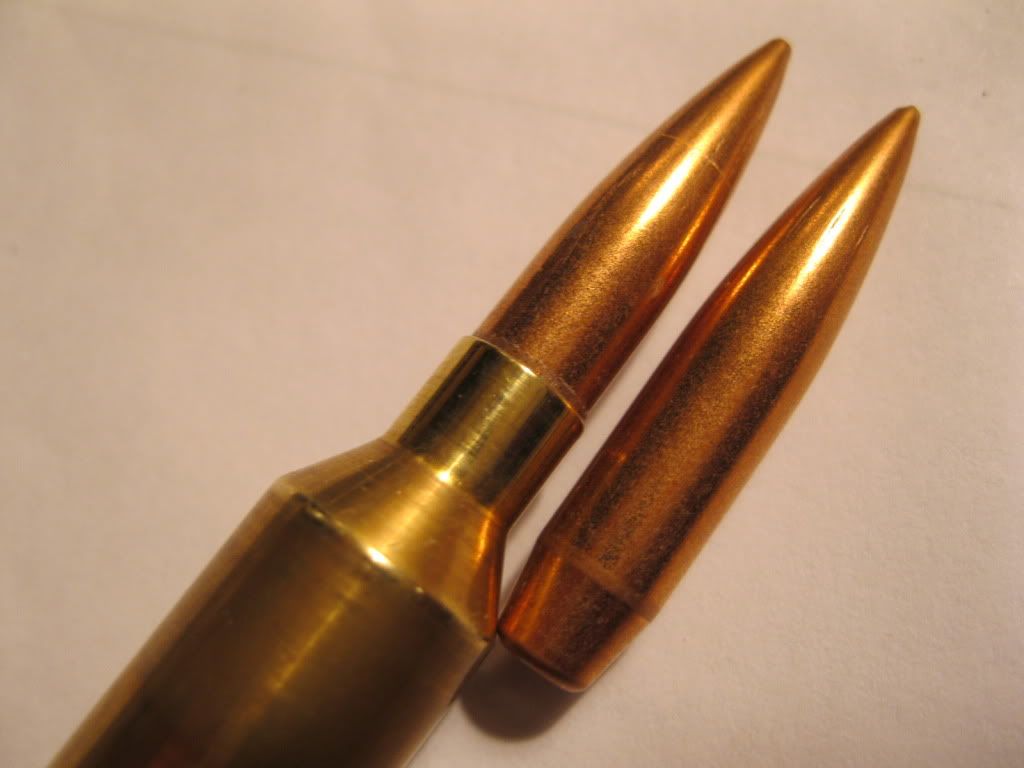

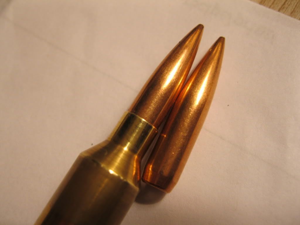

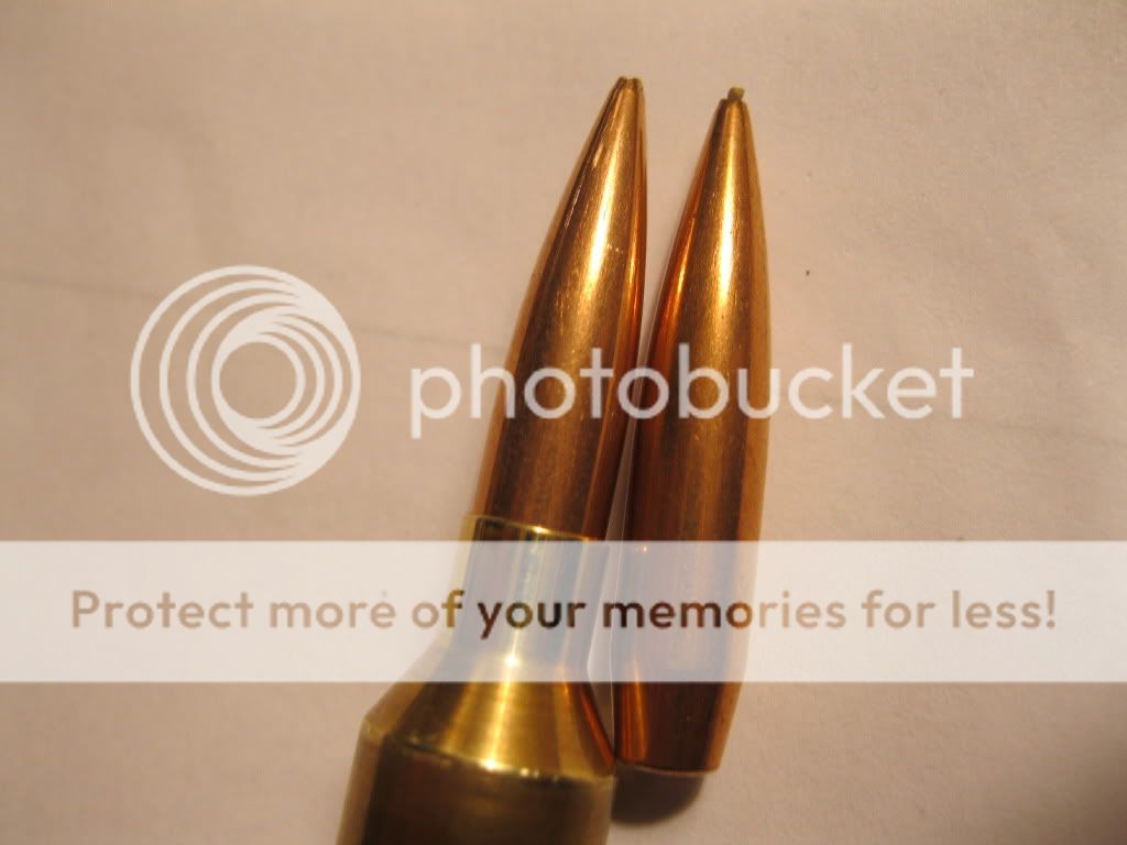

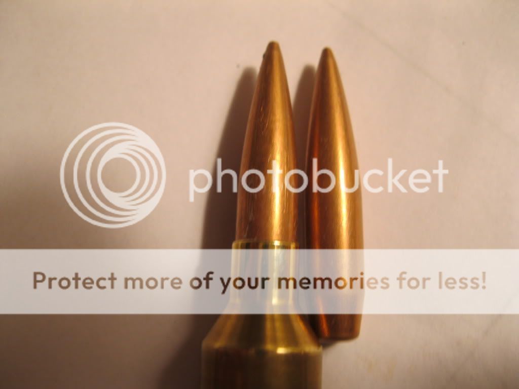

If you 2 are done for a minute, we can get back to our regularly sheduled discussion. FD didn`t remember I have more than 1 dog in this so here is another example of freebore done at my expense of another reamer. It is much better suited for his use of the 107 Sierra Matchking.
First in the same order is the Berger 105 VLD
Next is the Berger 108 BT
Once again the 108 Bib
And finally the fabulous Sierra 107 Matchking
I really was suprised at how much fun I had setting these reamers up. It was a true learning experience. My meaning of this is not to get locked in on someones suggested freebore. As they can be improved on. This last freebore length is my personal favorite and it is a chamber of 1.565 1 1/2 degree leade angle and a .140" freebore.
The first series of pictures were with a 1.570" chamber a 1 1/2 degree leade angle and a .170" freebore. The .104" is dead and gone for me after all this, and anything less would be nothing more than set up for varmints. I do realise this is all personal preference, but take a look at the different bullets and how they sit in the case and now this may help a few make a much better informed decision when ordering a tool. I have had serious issues with my current reamer maker, and will be going a different route next time. I am tired of chasing a greased pig that likes to run around the barn. I hope this was a learning curve to help new guys out there and encourage any questions as we have a vast knowledge base here, Tim Claunch
