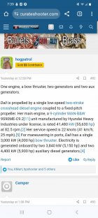

One engine, a bow thruster, two generators and two aux generators.
Dali is propelled by a single low-speed two-stroke crosshead diesel engine coupled to a fixed-pitch propeller. Her main engine, a 9-cylinder MAN-B&W 9S90ME-C9.2[11] unit manufactured by Hyundai Heavy Industries under license, is rated 41,480 kW (55,630 hp) at 82.5 rpm.[2] Her service speed is 22 knots (41 km/h; 25 mph).[5] For maneuvering in ports, Dali has a single 3,000 kW (4,000 hp) bow thruster. Electricity is generated onboard by two 3,840 kW (5,150 hp) and two 4,400 kW (5,900 hp) auxiliary diesel generators.[4]
