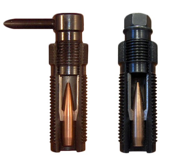

The Hornady Cam Lock Bullet Puller works very well in my Co-Ax and I use it pretty often as I can remove bullets quickly with no real damage to the bullets (just got to set it up just right so no damage is done):
