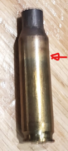

@Straightshooter1 Can you post a photo of the 10 second brass anneal? Curious what color the brass gets to.
I've already processed that box of Lapua cases and have some loaded up and ready to go to the range. But, just for YOU, I fired up my annealer and I grabbed some range brass sitting around and ran them through at 10 seconds. :D Here they are (different head stamped, from left to right are 2 Federals, 1 Remington 1 Winchester):
Except for the Winchester case, the necks were clean (no powder residue). The Winchester case had been run through the annealer a long time ago at less time and heat and the neck wasn't cleaned. My Lapua brass looked similar to the Federal bras except the necks, shoulders down just past the shoulder was that greyish color we often see when flame annealing with the powder residue left (the annealing was done before any cleaning).
In this pic, is 4 of my Lapua brass after my full process, with the only cleaning being steel wool on the necks and shoulders after annealing before sizing, then running them through my dry tumbler to removed the sizing wax. Note on the two middle cases you can see the indent on the necks made by the hardness tester.
For the rest of the box of Lapua brass, I decided to do something different than normal for me, for the first time in 14 firings, I wet tumbled them after annealing instead of just cleaning the necks with steel wool. I just wet tumbled for 20 minutes in very HOT water and Dawn with a little Lemi-Shine (no media). They came out nice and shiny and can hardly tell they were anneal, let alone annealed for 10 seconds. I still dry tumbled them with rice after sizing to remove the sizing wax. My Webster tool still indicates a 15, the target number I was after. When loading some, the seating felt very nice and consistent. Am looking forward to seeing what the chrono and target shows.

The one good place to use Tempilaq in teaching neck annealing was to demonstrate to the students how the heat propagates down the case body. (That is also a back-handed way of saying the internet lore of using the 750F on the necks is not a good method.)
By painting a stripe of 400F Tempilaq down the case body and then running it through the process, the trainees got to see how far down the body the 400F line would go.
Generally, even when using a relatively "slow" flame annealing time, the 400F goes roughly a body diameter below the body-shoulder junction, and less when regular rates were used.
If you noticed the "patina" created on Straighshooter1's brass photos, somewhere about the end of that patina is where the 400F level would be seen. This level is way above the level where the case body tends to fail due to stretching. YMMV
And it should be noted, like on this Winchester brass, the thinner the brass the faster it'll heat up and that "patina" is further down the case body than the others having used the same amount of heat and time. :)
