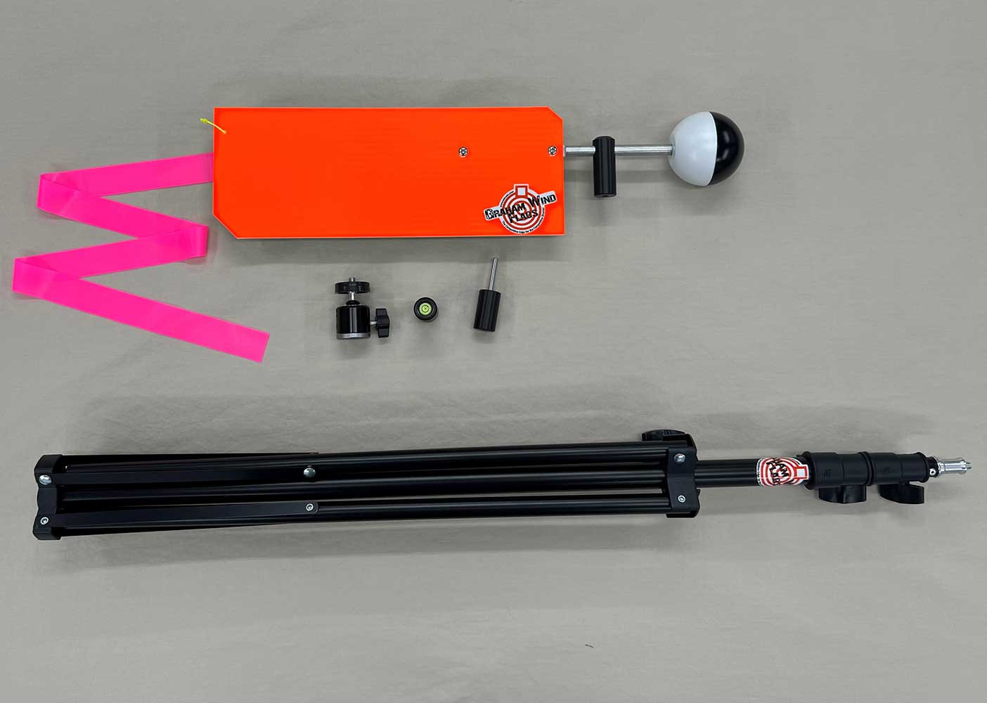

I use 5 flags set out from 5 yds to about 35 yds. Sometimes my close flags tell the story and sometimes it's the further flags that speak to me. The more I shoot over my flags the more I learn. I also like to practice when the wind is blowing. Here is what my flag set looks like.
Wow! What a set up. That is a lot to take in. Are the yellow ends for how the wind is moving up and down?
Yes sir, the yellow and blue tails are used to judge how hard the wind is blowing.
I'm new to 22LR benchrest. I tried three different types of flags over several months and these are the ones that work best for me. It's a very simple flag setup compared to other types of flags I've seen. After shooting over them for about six months I have started picking up on what they are saying to me. And I'm still learning every time I shoot.
Where did you get them from?
They are Graham Wind Flags....rimfire ball wind flags. He is also a sponsor on this site, Mr.Spradlin is his screen name.
