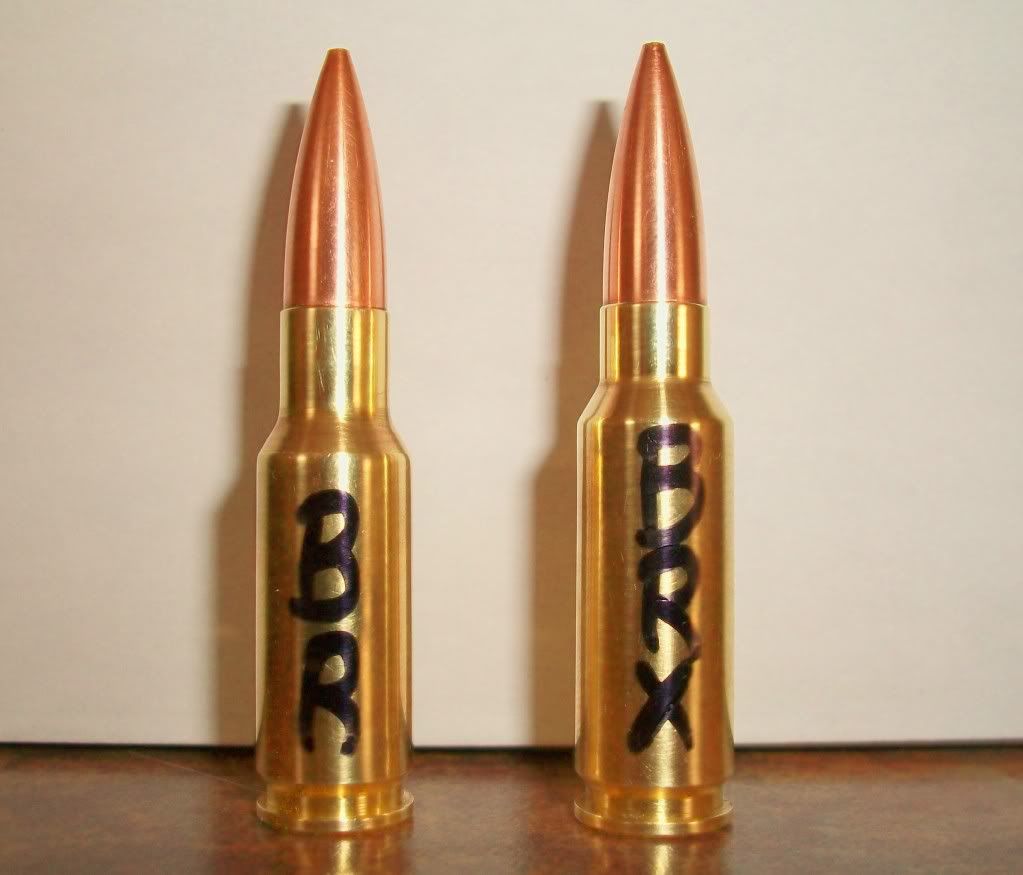

Fireformed 50 of these. On the left is pre-fire forming. Fireformed case on the right has shoulder blown forward .100. As per always, the recipe was simple: load, seat bullet hard into the rifling, lightly oil the cases, press trigger that's attached to a modern, strong action. Repeat 49 more times. Yawn. ;D
Imagine my surprise when nothing bad happened. :o
Again..... :D
Good shootin'. -Al

Al, cool pictures. I love the 6BRX, it's such a cool looking cartridge.
Wayne

Wayne: Yeah, the BRX's are cute 'lil devils, aren't they? :)

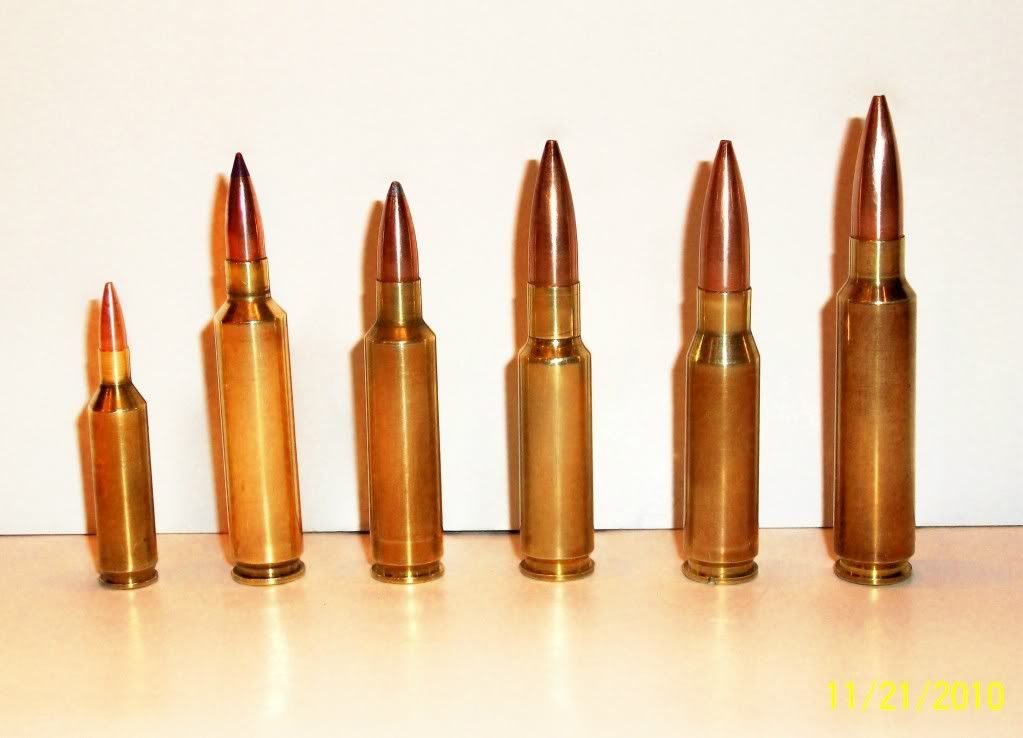

Here's a few others I've f-formed (lightly lubed) over the years for various hunting and BR rifles.
Lt to rt:
.17 Javelina, 243 Ackley, 250 Ackley, 30X47HBR, 30 WareWolf, 30X284 BeWare
All were lightly lubed prior to fireforming. Actions were various Remington 700's and Stolles. WD40 and 3-in-One were the most used, though at least one was done with a thin wipe of Imperial Sizing Wax....doesn't really make a difference as long as there's a bit of lubricity.
Headspace is consistent 'out of the chamber' and case thinning is minimized at the back end.
Let us know how your f-forming goes...that 7.62X39 stuff can be a struggle.
Good shootin'. :) -Al
