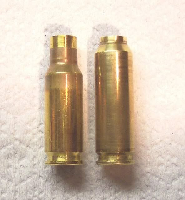

I shoot a 6PPC, with cases that are fire formed from a .220 Russian. There is undoubtedly some initial stretch involve in the fire forming. I have fired some of the cases untold numbers of times, at very high pressures. As long as I watch the bump closely there is no problem that can be attributed to whatever stretch took place during fire forming.

It seems to me that your real concern is preventing the case thinning near the head, as you show in the photo below:
If you fire a case over and over again with excessive or even normal headspace it will stretch, go thin, and eventually crack right where you indicate in your photo. The way to prevent it from happening is to only partially size the neck of your case, and not keep bumping the shoulder way back. If the case gets to the point of not chambering easily, then just bump the shoulder 0.001" back. You should be able to get 20+ firings out of each case by using this method. With 300 cases that will require about 4 barrels to use them up.

Submitted for your approval, in the hope that you're actually willing to explore possibilites, is this photo. Case on the left in its unfired state. Case on the right is the f-formed configuration. The parent cases shoulders are blown forward fully .240 during the f-forming process. There have been no case head seperations, fired cases last upwards of 50+ firings and lubrication :o is used on the cases during the f-forming process.
How can this be? ???
