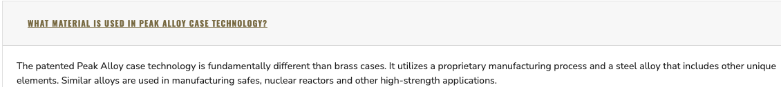

Forum Boss: This new cartridge has a steel alloy case and operates at a very high pressure. The idea was to offer higher velocities in a hunting rifle with a relatively short barrel. I see it as a gimmick... but the concept does have promise for the military.

They have an FAQ lower down on the Backcountry page that answers some of your questions. They do say it will be reloadable.

Not reloadable yet. Supposedly it takes about 12 passes through a sizing die just to get the shoulder to move.
That was my first thought, was thinking hmmmm those cases sound like they'd be very difficult to size. Even if say for the most part they don't need sizing, at the least, I'd think you'd need to size the necks and wouldn't that present the same problem if they didn't or wouldn't size and just sprang back. I mean how the heck would you control neck tension....
I'm wondering why they decided to do the entire case in this new alloy as opposed to just the case head like the 277 Fury. A brass body with an alloy base would make reloading way easier.
Yeah and not to mention about doing an anneal. May need to break out the
mini argon furnace. I wonder if the people at AMP are scratchin' their heads
yet......I'd like to get my hands on at least one case to play with.
