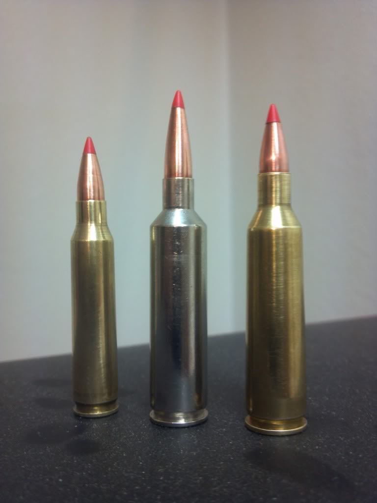

From Left: 223 55gr. V-Max, 22-250AI 75gr. A-Max, 22-250 55gr. V-Max.
All three are great rounds...And all have their purpose
