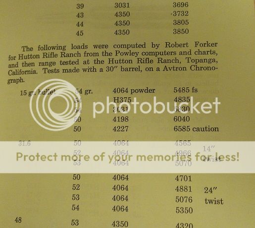

If you're looking for extreme then I read a story somewhere that the DoD paid Roy Weatherby to see if he could get 5000FPS, if I recall correctly he did, or close to it, with something like a 22-300wbymag. (probably shoot half the barrel life zeroing a scope.)
I bet a 35 would hit 5K out of the 22/284.
Playing with QL the best chance would be something along the lines of an '06 AI or greater.
Somewhere approaching 5K you start running into the limit of the gasses rate of expansion. That's why the high velocity experiments by the Navy and the AF have used magneto rail guns and light high pressure gasses.
Brood over this. 22-284
