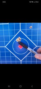

1st picture is 80gt eld vt seconds loaded with lever, five shots around 40 thou off lands. Mag length

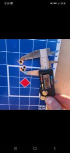

2nd picture 75gr vmax from Druid hill armory. 4 shots

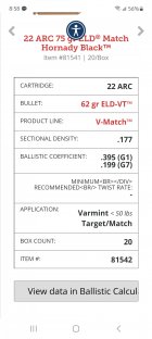

Hornady does not state a twist rate of 7 twist is required for the 62 eld VT 22 arc ammo. They don't actually state anything.
