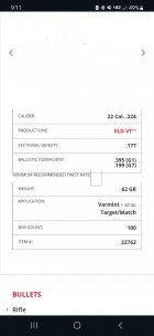

Will be very interested in how they do.
What gun will you be using? Hopefully a bigger wildcat ;) but even a 223 will give us good intel.

223 ai 1-8, 22xc 1-8. Hornday claims they will blow up with a bigger case like the 22-250 ai and the xc
I'll be running the snot out of them in a 22-250AI with an 8 twist 20" barrel.
I'm expecting/hoping for 3500 fps
I'll post any results I have, hopefully this weekend!

Post your results with ARC … guessing 4895, H335, 2230, etc will all push that thing near 2960+. I m shooting 80 Blitz at 2920. It’s a .300 bc vs that Hornady published at .395!! That s a big difference.
