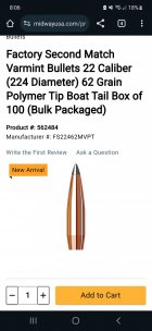

Check out and sign onto Nosler's (Shooters Pro Shop) as they have various 2nd and blemished bullets for sale fairly regularly. But you must be fast there also, quite often.
Will be very interested in how they do.
What gun will you be using? Hopefully a bigger wildcat ;) but even a 223 will give us good intel.
Matt
223 ai 1-8, 22xc 1-8. Hornday claims they will blow up with a bigger case like the 22-250 ai and the xc

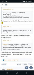

I bet they don't come apart in my barrels.
I think it's the length that blows up bullets and tight nodes.
Too bad im out of money for the year haha. Im fixing to screw my 22xc on this weekend. With them being close to the 75gr i will back it off 2 gr and start there
I would suggest that one stick with relatively mild loads. 38.5 grains of h4350 with a 75 ELDM is 3350 in my 26-in barrel. I would think just slightly over that would be plenty considering the incredibly high ballistic coefficient from this new bullet.

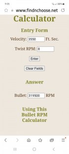

Terminal RPM for an eight twist is about 3550. Many varmint bullets could go above that because of their blunt nose shape. I'm not sure this one will tolerate much above that. We shall see.
