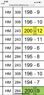

All prevalent caliber choices were represented in the top ten F-Open scores at this weekend’s Texas midrange championship. The scoresheet this time did include caliber (diameter) choice, not to be construed as the cartridge used that may go by the same name.
300 mags aggregated 1st and 2nd place, followed by a pair of 6’s and a pair 7’s. Even a 6.5 appears. While the earliest relays were calm, wind reading skills determined score for everyone for at least two of the three matches both days.
For the record David: despite the scoresheet, the 1st place was shot with a 6mm.......
David, another clarification. The 6.5 was actually a 6mm, too. Game day decision to go with a Dasher. So, 50% of the top 10 were shooting 6s.
