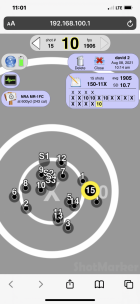

Like this?
what does the Ninja know. the only reason he shot the 10 was he would have run out of AMMO!!! Watched it!!!!! That 10 was only after he stopped shooting, stood up smoked a marlboro then laid back down and shot the 10....
And he probably shot 4 sighters and 25 X's in a little over 3 1/2 minutes, had to wait on that damn 7 second delay.....
What’d I say about tobacco.
