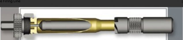

When I trim my cases with Lee Case Length Gauge, on the external side of the case mouth come up a big lip very hard to remove with MCJ Rocket type chamfering and deburring tool ad Lee tool.
So please can someone advice me how I can completely remove this external lip?
