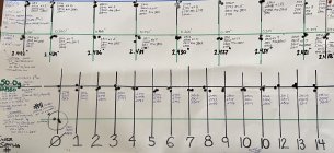

Well the good bad and the ugly
the test was bad it sucked the es/sd was suckin to say the least
shot 50 rounds es128.03 sd24.84
started the tuner out on 0 three shot groups up to 10 on the tunner 30 sh0ts total
as you can see the groups opened and closed throughout the test
but the load was fu as you can see the tuner wont make a sucky load better but the groups got smaller and bigger even with a bad load I need to get the es down below 30 and the sd in the single digitsView attachment 1446900 and do this again cheers hope this was helpful for someone
all in all it was still a fun 2 and a half hours at the range with all of the other old men Cheers
For his sake, I sure hope these weren’t 100 yard groups. If so, the groups are horrible. In fact, if these groups were shot at any distance under 400 yards, I’m not impressed one bit with his ability to shoot, therefore making the results of his tuner testing virtually useless.

Well no shit Dave I already stated the groups sucked with that kind of es/sd what do you expect and yes it was at 100 yards and far as my ability to shoot all my tuner testing is done with a machine rest
