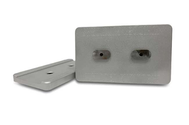

I have some MPA and MDT chassis but not the best for good tracking in a rest unless you fabricate or purchase a forend adapter.

I will help save you some time. These plates work nice on the MPA:
