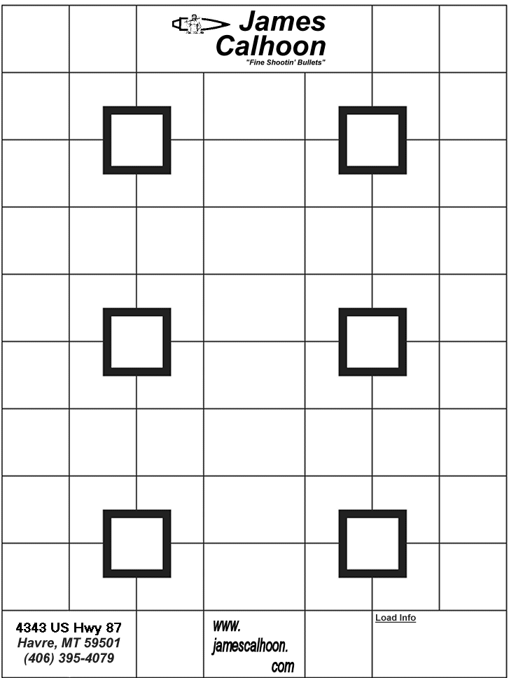

I pay about .30 a sheet, ordering 200 at a time.I get 2 of these per sheet6 br  Bat M.jpg
You can't print at home for that$$.
