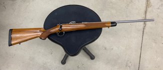

Long live quarter bores. I’m currently enjoying a 25x47 shooting 110 BIBs, I have a 25 Saum Improved inbound, should be here next week. Sent Zack at ODCR a Kimber in 270 WsM, had Lilja copy the profile, I wanted to keep it light. It’s set up to shoot 110s, I have the heavy bullets with dial a deer rigs covered but I wanted something fast and light for this one. Came out nice. Rebarrelling a Kimber with a matching profile looked like a pain. I went old school and had the barrel bead blasted.
