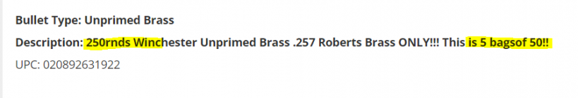

Yikes.... https://ammoseek.com/ammo/257-roberts
This looks really reasonable: https://www.gunbroker.com/item/923107354
