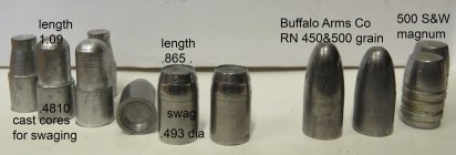

I used LEE LIQUID ALOX lube on those 500 S&W Mag FN cast bullets. Hoping some body can show me what I'm doing wrong, Bullets do load easy but very poor group at 50 yards and some looking like they were starting to go side ways, thanks. Free Trapper

Unless your barrel is totally leaded up I don’t think your issue is lube. I would look into twist rates and diameters if you have bullets going sideways.
There are some tutorials and findings on casting for revolvers around. Chamber, cylinder throat, forcing cone and then the bore diameter.
What OD is your bullet?
In a nut shell look for “choke” or at least the same all the way to the muzzle.
If you start of say at.505, then it drops to .500 some where in the middle, but your barrel groove is .503, all the love and care won’t help.
I cull my CB’s really hard. They need to look exactly like the inside of the mold.
I quit using molds made for the masses, to much margin of error, like the box of chocolates ya. Ever know what your gonna get.
Some slugging and measuring will tell you in short order where your problem is and what is needed to fix it. Then buy a custom mold. They are a bargain for what you get.
If one just wants to shove a bullet in a case with good results stick with jacketed to relieve frustration.

Thanks JSH for your input, I have a GM .50 cal bore barrel groove to .510, 1:28 twist, Setup for muzzleloading. Cost was a big factor in trying 500 S&W MAG, FN 440 grain bullet. Lee mold for that bullet came with a .501 sizing die plus LEE LIQUID ALOX lube. Said bullet coated with ALOX loaded easily smooth down the barrel on top of 70g 2FF follow by card wad, felt lube wad and another card wad than seated bullet. Bullet has a solid base, been casting with pure lead no tin as of yet. Grouping was so bad I just stop playing with it and went to a paper patch bullet from Buffalo Arms Co trying 450-500g swag RN 1.0560 - 1.1415 long .492 dia, smooth sides no lube groove. At 50 yards shooting 3-4 inch groups with Iron sights (peep for us old guys) I like the Buffalo Arms paper patch bullet but are not cheap. I do plan on making my own swaging dies will post pictures on my first attempt in trying. Still would like to make that 500 S&W MAG bullet work, using Miller stability formula Calculate bullet at 3.485 on the green chart, numbers reading between 1.03-2.0 are suppose to be the best. My Paper patch bullets measure 2.062-2.211 on the green chart, seem longer bullets make them more stable.bullets-1.jpg
Google 500 S&W Magnum handgun showing one model using 1:18.75 twists. Muzzle velocity 1625 F/s, cast bullet dia .501 Using Miller stability calculator shows that bullet stability 8.267 in green chart.
With my GM barrel .50 cal-.510 groove 1:28 twist muzzle velocity 1150 F/s bullet dia .501 show bullet stability 3.485 in green chart.
I read stability value should be in the range of 1.3 to 2.0 to ensure bullet stability. I'm a little lost, so a bullet with 8.267 in green chart better or worse?
I reread everything I think.
So your trying to use a bullet intended for 500SW in a 50 caliber muzzle loader?
The 500SW is a .501 bore where as the BP rig is .510. The muzzle loader is a 1-28 ROT where as the 500 SW is listed as a 1-18.75 ROT.
Undersized and too slow of a twist are working against you. The design does not lend itself well to a muzzle loader either I would think.
